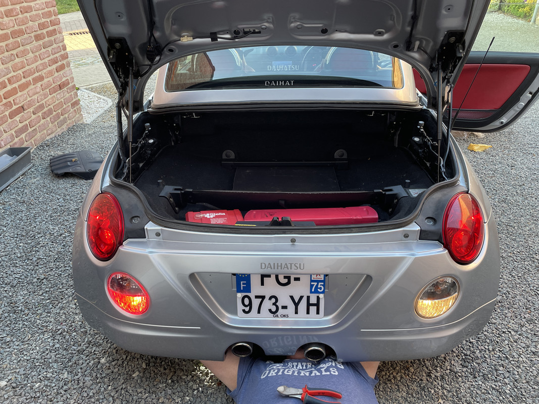

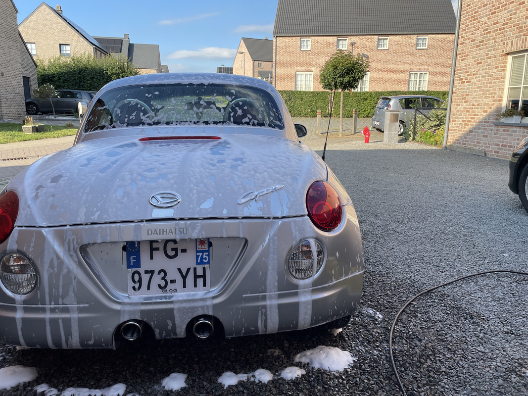

    For those who have the same problem, I've fixed it :
    I bought some european headlights from someone on Facebook, and bought a rear reverse light from an European copen, so I have "two" reverse light, I inversed the cables from the fog lights and reverse light so when I turn on fog lights it lights up on the left, and when I shift into reverse it's the right side that turns on, like this :
    Since it's a clear lamp I needed a red colored LED lamp, I took a cheap one from amazon and seems to work good.
    Result :
    So it's basically symetrical like a Japanese copen! Looks super cool
