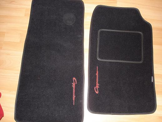

    This is the company that did my mats for the Cappuccino. I checked again, they were only £65 not £75. Still pricey, but very good quality.
    http://www.autostyle.co.uk/
    They don't list the Copen though.
    These are the mats they made for me.
    There are "tailoured mats" on ebay £20-£35.
