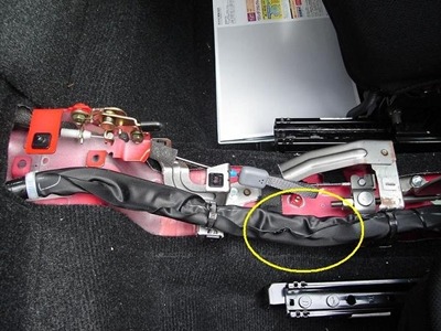

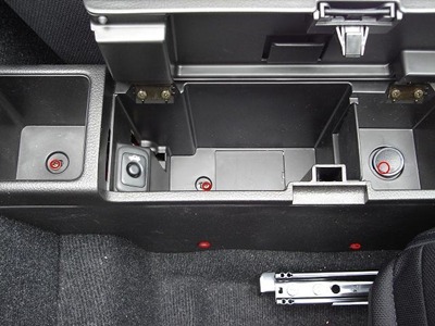

    :) Remove centre console.
    :) Once removed, cut out the wire wrap as shown with yellow circle.

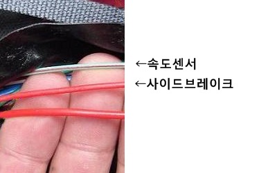

    :) Once you have cut open the wrap; you'll see 3 wires.
    First arrow: speed sensor (light greeen colour; looks white to me)
    Second arrow: side brake sensor (thinner red wire out of the two)
    Third (no arrow): power

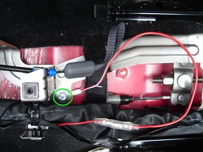

    :) Cut the side brake sensor wire (thin red wire)
    :) Once it's cut; extend the cut wire that is coming from the rear end;;
    connect to earth. (For this, you don't need to pull the side brakes up
    to open the roof)
    :) Lastly, cut the speed sensor. Now, you can open the roof while driving.

    That red extension wire looks only just long enough to reach the earthing bolt!
