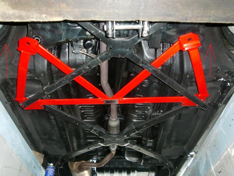

    I spoke to Scooty at the KKITP two years back about bracing. He said the best improvement he noticed was with one of these:
    Tanabe Sustec UBD5 under brace
    http://minkara.carview.co.jp/smart/...00/003/543/823/3543823/p1.jpg?ct=492905c1211b
    So I would go with the Ultra Racing 4-Point Front H-Brace (UR-LA4-1667)' or try to get a Tanabe, I have seen one on eBay before.
  15. scooty
    Absolutely agree with Adam, the most noticeable one is the Tanabe Sustec UBD5 under brace. It really is doing a perfect job.
    Photo by fjutsha@forum.micro-roadster.de
    Don't know anyone yet with the Ultra Racing 4-Point Front H-Brace (UR-LA4-1667). But could be worth a try.
